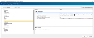

No, i don't want to reserve the pin 0.18 (reset pin) for reset, so i undefined CONFIG_GPIO_AS_PINRESET. I want to use the pin 0.18 for another using.
I'm using nRF5SDK.

Hi Ceda,
If you are using SES I don't think this generally should be a problem.
Could you try to simply recover the chip with the terminal first, running "nrfjprog --recover", and then try to use SES like you normally would and see if the error is still there?
If it is, we would have to see if CONFIG_GPIO_AS_PINRESET is defined someplace else in your common configurations in SES.
Elfving
Hi Elfving,
I tested "nrfjprog --recover" but the error still there.
CONFIG_GPIO_AS_PINRESET is undefined in my ide.
