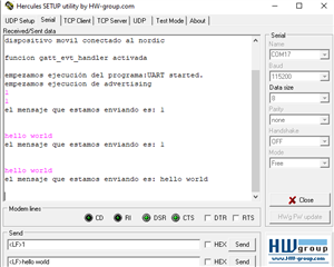

hello. im having issues using ble uart, im planning on connecting my phone to nordic by bluetooth and to pc by usb, the problem that I have is when I use a usb port terminal like "hercules" or "putty", when i try to send a message from Pc to smartphone, i cant see the message on NRF connect app on the characteristics RX/TX, even if i enable notifications, comunication for sending messages from pc to nordic to smartphone works but not the other way around, I guess the problem is in the main code, my pc doesnt have bluetooth, if anyone can help.
my main code is:

  • void uart_event_handle(app_uart_evt_t * p_event)
        static uint8_t index = 0;
        uint32_t       err_code;
        switch (p_event->evt_type)
            case APP_UART_DATA_READY:
                index++;
                    (index >= m_ble_nus_max_data_len))
                    if (index > 1)
                        NRF_LOG_INFO("entramos en la funcion");
                        printf("\r\nel mensaje que estamos enviando es: %s\r\n",data_array);
                        do
                    index = 0;
            case APP_UART_FIFO_ERROR:
            default:
    i changed this function and it kinda works, the problem is that i have to send data twice for me to get the data that i want, it is stored in the memory here is a picture: "el mensaje que estamos enviando es"(the message we are sending is) :
    I noticed that you accidentally tagged nRF Connect SDK, but the example requires nRF5 SDK.
    I have tested your example and didn't have any issues with your corrected version.
    Dejan
