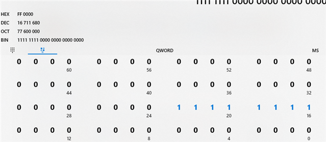

    How do I set the color? according to the driver the 2nd variable should set the RGB color.
    drv_ws2812_set_pixel(uint32_t pixel_no, uint32_t color);
    but my 2nd variable set brightness (of blue only)

    Here is the doc for drv_ws2812_set_pixel:
    /**@brief Function for setting the specified pixel in the LED state buffer to the specified color.
     * @param[in] pixel_no  Number of the pixel in the LED chain.
     *                      Specify a value in the range from 0 to @ref WS2812_LED_CHAIN_PIXELS_COUNT_MAX-1.
     *                      Values out of the range are ignored.
     * @param[in] color     Color to be set. Use the RGB format. Bits 23 to 16 are for the red component,
     *                      bits 15 to 8 are for the green component, and bits 7 to 0 are for the blue component.
     * @note Call @ref drv_ws2812_display to update the LED chain from the frame buffer.
    void drv_ws2812_set_pixel(uint32_t pixel_no, uint32_t color);
    So for red, try setting color to  e.g. 16711680 (bit 23 to 16 set to 1).
