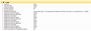

2. now I add the S140 hex as additional load file and change the memory placement to:
MEMORY
  FLASH (rx) : ORIGIN = 0x00027000, LENGTH = 0x000D9000
  RAM (rwx) :  ORIGIN = 0x20001678, LENGTH = 0x0003E900
build and link is OK but when download the the target i get

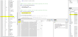

    I debugged further in asm and compared to example projects. So there is the NVIC_SetPendingIRQ where it descends into the S140 0x00025F.. but fails when try to load the address in R3 (what was in 0x20000004) . So I maybe the RAM is not initialized correctly?

    Maybe you have some additional load files in the project settings that will overlap with the application. Could you provide the Segger programming fail log?
