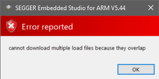

Cannot download multiple load files because they overlap (external gcc with load script)
The Project (on a NRF52840) is setup to use an external toolchain (for C++) and we use the S140 softdevice (v7.2.0) for BLE stuff.
1. without loading the  S140 hex file and disable all related stuff in code and the following memory placement defined in the linker script:
MEMORY
  FLASH (rx) : ORIGIN = 0x00000000, LENGTH = 0x00100000
  RAM (rwx) :  ORIGIN = 0x20000000, LENGTH = 0x00040000
OK
2. now I add the S140 hex as additional load file and change the memory placement to:
MEMORY
  FLASH (rx) : ORIGIN = 0x00027000, LENGTH = 0x000D9000
  RAM (rwx) :  ORIGIN = 0x20001678, LENGTH = 0x0003E900
build and link is OK but when download the the target i get
I see a lot of problems in the Q&A but all with the SES section placement macros.
sources: Adjust RAM/Flash memory

    If you are using s140_nrf52_7.2.0_softdevice.hex, the application should start from 0x27000. Because the flash size of SD is 156 kB (0x27000 bytes), RAM is 5.6 kB (0x1678 bytes). You could try the following setting. If it still has the overlapping issue, you could use nRF Connect for Desktop/Programmer to check the memory layout.
    MEMORY
      FLASH (rx) : ORIGIN = 0x27000, LENGTH = 0xd9000
      RAM (rwx) :  ORIGIN = 0x20002300, LENGTH = 0x3dd00
    Amanda
    Thank you, this is almost what I tired (RAM was different, why 0x20002300 and not 0x20001678?). I do not see any more information in the nRF Connect Programmer.

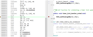

    I see the MBR and Softdevice are from 0x0 to 0x26633. So I should be able to load the application into 0x26634 or 0x26700 but that doesn't work. Below 0x30000 it complains about overlapping memory space.
    So I load it into 0x30000. Debug:
    int main(int argc, char* argv[])
        using namespace std::placeholders; // for _1, _2
        ERROR_CHECK(app_timer_init());     //App Timer Init
    in the app_timer_init() here it will fail:
    static void timer_list_handler_sched(void)
        NVIC_SetPendingIRQ(SWI_IRQn);
    it jumps to address 0xA60
    Side note: the linked memory map is for the S112, here is the S140 Memory Map
