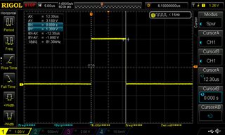

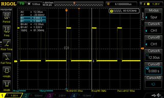

  • unwanted signal: always the same width, but random frequency
    This channel should be always zero!
    duty-cylce is set to zero, but i have this random pulse. the width is alsways the same
    this is the signal of the second channel. works correct.
    This is the signal of the other PWM channel, this one is correct.
