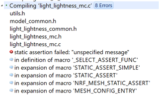

static assertion failed: "unspecified message" When adding light lightness model to light switch sample code
Hi
I am now trying to add the light lightness model to the light switch sample code in order to use both the light switch and light light lightness features.
After adding the code that I think I need from light lightness to light switch, and adding the necessary h and c files, I get the following error.
How can I fix this?
I would appreciate it if you could tell me.
I'm using
nrf5_SDK_for_Mesh_v4.2.0_src
nRF5_SDK_16.0.0_98a08e2
Thank you.
  • Hi, Amanda
    I checked code in nrf_mesh_config_app.h again and realized that I forgot to add the code below.
    Thank you for your your advice.
    #define LIGHT_LIGHTNESS_SETUP_SERVER_INSTANCES_MAX (1)
