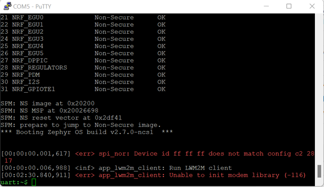

Hi all,
I´m trying to test the LWM2M Client sample.
After following all the steps explained in this web, when I run it and connect to the DevKit via Putty, I get the following error message after rebooting:
Unable to init modem library (-116)
Where can I find what this error is about? Why is this library not being initiated? I haven't changed anything in the example from the SDK v1.8.0
Thanks and regards,
Juanjo

    Which modem fw are you using? are you sure you're on the latest version (v1.3.1 at the time of writing this response)
    Does any other samples, like the at_client + LTE Link Monitor work at your end?
    Håkon
  • Yes, I'm using the latest FW available. (v1.3.1)
    AT_CLIENT sample does not work as well. All I get is "ERROR" after sending "AT" or other command.

    Are you using an older nRF9160-DK?
    Could you share which version of the DK, or the IC itself that you are using?
