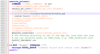

but adding any of these lines to prj.conf will cause a cmake error:
CONFIG_SPI_NRFX=y
CONFIG_SPI_0_NRF_SPIM=y
Any help getting a spi async master sample?
