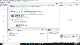

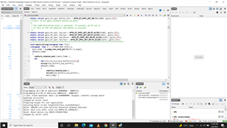

CPU reset during Debug
Hi, I testing the code using nrf5340DK kit written using nRF Connect SDK in SES. The CPU resets automatically, after few lines of code. The Output code and Task images are atached.

  • Hi Gulzar
    It seems it is the call strcpy that is causing a memory fault, which implies that there is an issue with one of the buffers (esp_buffer1 or esp_buffer).
    Can you let me know how these buffers are defined?
    Also, using strcpy is a bit risky unless you are sure that there is a terminating null character in the source string.
    It is better to use strncpy, so that you can define a maximum length of the copy operation, which should be set to the size of the destination string.
    The memory bus fault could be caused by overrunning the destination buffer.
