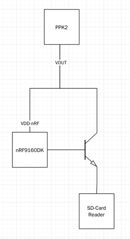

I've been using the PPK2 to measure the current draw of the nRF9160DK. However, spi peripherals are not included in these measurements. I was told that if you power the peripherals from nRF_ref they would be but I'm not getting any/the right amount of voltage from those pins. Only the regular VDD ports seem to work. My board is in 3v3 mode.

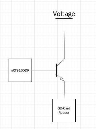

As the sd-card draws current, I need to be able to either cut power to it when not needing it or dismount it when not needed and mount it when needed.
In the first case, I would like to set a GPIO to 3v3 output and control the pin from software, I have tried this but can't get the gpio to supply the same as VDD pin.

  • Hi
    2. I need to be able to turn on and off power to the sd-card which requires a configurable pin. That is, I need a gpio pin with an output equal to VDD
    Supplying peripherals from the GPIO pins are not recommended. To see the capabilities of the GPIO pins, see GPIO: Electrical specification.
    I would recommend using a transistor for toggling the power to the SD-Card module. For example like this:
    1. I need to measure spi-consumption on the PPK2 but the nRF_ref does not provide the same voltage as VDD
    If your goal is to measure the current of the nRF9160 and the SD Card reader, I think the simplest solution would be to power both directly from the PPK2 in Source Mode, like this:
    Will this solution work for you?

  • Hi Sigurd and thank you! So the transistor would function as an and gate of sorts? I'm new to the electronics part of this, would any transistor do or is there a specific one I need? Do I need anything more than a transistor, breadboard and wire? When using the ppk2 as source, can I jump the vout to both the dk and the sd-card reader without the transistor using breadboard and wires?

  • Hi! This is my setup(forgive my paint skills) when using source mode:
    I do have a usb connected to the DK for programming and that would explain the noise. However, can I split the vout from the PPK2 to connect to both nrf_ref on P22 AND supply on P21? If not, would there be a reasonable assumption that the current from ampere mode is the correct one and the added one I get in source mode is due to noise? I should also point out that the ground from PPK2 is connected to the negative terminal on P21.

  • Hi
    You connection diagram looks fine.
    Keep in mind that on the nRF9160DK, there are three chips.
    Debugger
    nRF9160
    nRF52840
    When you measure on the nRF_VDD, you only measure the power consumption of the nRF9160.
    I suggest you stick to ampere mode for measuring.
    Also see Getting started with current measurements on the nRF9160 for some tips.
    Sigurd Hellesvik
  • Why I changed to source mode was to be able to measure the SPI peripherals. If I go back to ampere mode, the peripherals are not included unless supplied by the VDD_nRF but that voltage is not enough to use the peripherals. Can I assume the current draw from perihperals measured from source mode is the same in ampere mode? That is, in source mode, voltage from dk with sensors - voltage from dk = sensor consumption.
    Yes of course. So you will need to use Source mode.
    Disregard my previous statement, I were confused for a bit since Source and Ampere showed different measurements.
    Then I found that the USB is supplying 5V, while in Source Mode the PPK2 is supplying 3.3V.
    This is the reason for the different current measurements. If you want Ampere mode to measure the same as Source, set the Power of the Source Mode to 5V. Be careful to check if your peripherals can handle 5V.
    So both Source Mode is fine.
    I still would recommend every part one at a time and sum it up once, it will give some more insight and a good double check of things.
    Then you can measure everything at once and know approx what you should get.
    Did this make sense?
