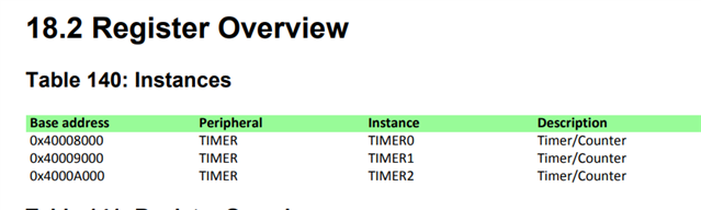

    app_timer uses RTC. But app_pwm will use a TIMER instance.
    There are 3 TIMER instances on the nRF51.
    Softdevice uses TIMER0, so 2 timers left for the application.
    app_pwm uses 1, and timer_init() code uses 2(m_timer_count and m_timer_read).

    With e.g.the nRF52832 you have a dedicated PWM peripheral, and 5 TIMERS.
