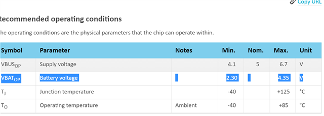

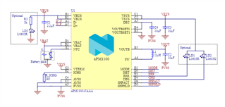

I want to configure the NPM1100 to work with either rechargeable or non-rechargeable batteries (in factory).
Would it work to set mount a suitable resistor to the NTC pin, and fool the circuit into believing it is to hot ? Would this have any negative consequences for functionality or performance, e.g. current consumption ?
