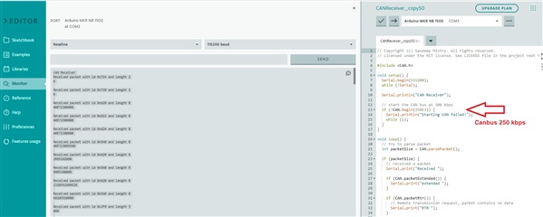

This is the next step of the process getting the canbus working with nrf9160 and the aditional MKR CAN shield from arduino

As requested from the previus ticket i have checked the SPI bus and it seems to work.
This is the text on the terminal:

  • Hello Tomas,
    T.B-D said:
    You asked about my integrations. Here is a privius upload of the chematics connections.
    Thanks for that!
    T.B-D said:
    I had some strange messages coming up during prisitne build so i decided to import the project again in to VS Code.
    Now i don´t get the stack owerflow.  Then im back again that i don´t see any can message coming in.
    Unfortunately, I can’t tell you the reason for that. But I assume you re-imported the exact same application, or are there any changes?
    Markus
