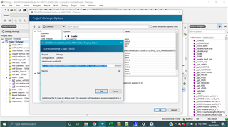

                I am using NRF52833 in my project. I am also using RTOS in the code. I was previously working on NRF52840 but now I have migrated to NRF52833. I have changed all the required settings but still I am getting error in ble_stack_init function. I guess it is due to some wrong configuration of memory areas. My current memory configuration is as follows:- \
Memory segments - FLASH RX 0x0 0x80000;RAM1 RWX 0x20000000 0x20000
Section Placement Macro -
FLASH_PH_START=0x0
FLASH_PH_SIZE=0x80000
RAM_PH_START=0x20000000
RAM_PH_SIZE=0x20000
FLASH_START=0x27000
FLASH_SIZE=0x59000
RAM_START=0x20003278
RAM_SIZE=0x1cd88
<!DOCTYPE Linker_Placement_File>

    What SDK and SDK version are you using?
    Have you done a debug session, figuring out where it fails and with what error message?
    In nRF5 SDK, the SoftDevice is handled by the SoftDevice Handler library, so I expect the ble_stack_init function to use the API of that library, such as nrf_sdh_ble_enable() call. Which function fails, and with what error return value?

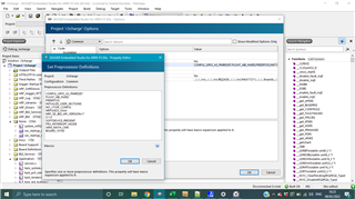

    Note that when changing SoC, there are also some preprocessor defines that may need change or adding. For instance, for an nRF52833 project you typically need NRF52_SERIES, NRF52833 and NRF52833_XXAA, while for an nRF52840 project there are NRF52840 equivalents for those preprocessor defines.
    Flash and RAM settings depend both on SoC and on what SoftDevice is used.
    Terje

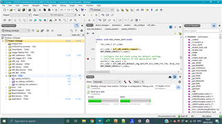

  • Hi Terje,
              I am using 17.0.2 sdk version. I tried to debug but it doesnt start properly. I am not able to go into main function,but in RTT terminal I get this error:-
    00> <info> app: TESTING NEW FIRMWARE
    00>
    00> <error> app: ERROR 8 [NRF_ERROR_INVALID_STATE] at D:\SNEHAL\NETOBJEX\PROJECTS\RECHARGE\SOFTWARE\board-bringup-code\MAX17211\firmware-recharge-nrf52833\src\main.c:807
    00>
    00> PC at: 0x00025D85
    00>
    00> <error> app: End of error report
    00>
    807 line is of nrf_sdh_enable_request() in my main.c.
    As you mentioned, I have already changed all preprocessors.
    The system and start up files are also replaced.
    Change debugger settings too.
    Still I am not able to start my stack. Can you please help me?
    nrf_sdh_enable_request() returns NRF_ERROR_INVALID_STATE (which is 8) if the SoftDevice is already enabled. Have you done any changes to SoftDevice configuration or initialization from the nRF52840 version of the application?
    Oftentimes it can actually be easier to find an nRF52833 example project, and copy the files from the nRF52840 project over to that new project. You could try that approach, to be sure all nRF52833 related includes and settings are correct.
    Terje
