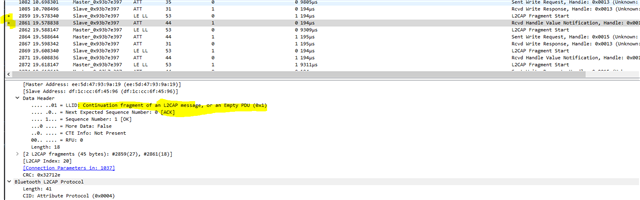

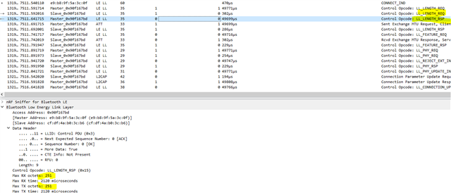

    To be able to know what wrong, I would suggest to capture a sniffer trace.
    With that we will be able to see very easily what caused the issue and why it take a long time for the returning command
    (Note that if it require a packet back and forth then it may take 2 connection interval meaning 50x2  = 100ms)
    Please download the sniffer software here and use a DK as the sniffer. Please follow the documentation on how to track a connection.

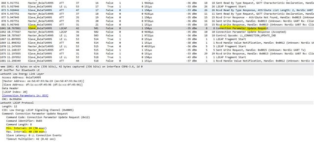

  • As far as I can see, for some reason the standard times of 30-50 ms are returning.
    q_00.zip
  • Hi Stefan ,
    It was because the peripheral requested the connection parameter. ...
    If you configure this:
    CONFIG_BT_GAP_AUTO_UPDATE_CONN_PARAMS=n
    on the peripheral side it will not request that again.
