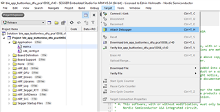

    The issue with debugging while a bootloader is present is that the bootloader will check whether the application is signed with the key. If it is not, then it will assume that the application is not authentic, and go back to DFU mode. So if you don't see the DFU LEDs, or advertisements, then it is likely that the application is starting, but crashing, causing the device to reset and start the application again.
    The easiest way to "debug" is to use the logging module in the SDK to see whether that says anything. If it doesn't then it is still possible to debug. In order to do so, you need to either upload the FW actually using DFU, so that the bootloader will sign the application image, or you can use nrfutil to create "bootloader settings" which is a small .hex file that you program together with the application (use --sectorerase for this file if you are using nrfjprog).
    When all of the components: BL, SD, APP, BL_Settings are flashed (or BL, SD and APP is transferred via DFU), then the application should run. The issue is that when you start a debug session, the compiler will not actually use the .hex file that you used to generate your DFU image, but it uses some debug file (.out / .elf, etc. depending on your IDE). When it flashes this new application, then the signature in the bootloader no longer matches the CRC of the application, and the bootloader will reject the application.
    So in Segger Embedded Studio, there is an option called "Attach debugger"
    Which will attach the debugger, and just assume that  the correct application is already flashed. Use this if you want to debug when a bootloader is present.
    Edvin

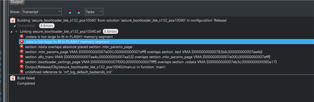

    I tried enabling NRF_LOG_ENABLED to 1, but it result in the error:
    If I understand correctly, the other option would be to create a separate application and add it as you mention. with something simple like nrf_log_info() and check if that works?
    Thanks again for all your help and hope you have a great weekend :)
    Yes, when you try to enable logging in the bootloader itself, then it will throw this error. It is because the start address of the bootloader is close to the top of flash, so there is not much space for additional features. It is possible to move the start address for the bootloader down, but it would be easier to start by looking for logs in the application, and see if it starts. Also, try the "attach debugger" button, to see if you can hit a breakpoint near the top of your main.c (and turn off optimization in your application, so that your breakpoint isn't accidentally skipped).
