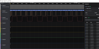

I2S Zephyr SDOUT not working
I am trying to get I2S communication up and running but am unable to produce a signal on my SDOUT pin. MCLK, LRCLK and SCLK work as intended but trying to send any data does not work. I did notice that the TXD.PTR register is empty. I have tried multiple pins for my SDOUT and have nrf SDK 1.8.0 installed, using VScode. Any help would be appreciated.

  • Hi thank you for your response,
    I tried on GPIO 36, 26, 0, 2 ,3. Removing "&" gives the same result unfortunately, and yes the data is properly populated within tx_mem_block before i2s_write() is called. To view the TXD.PTR I use "Cortex-Debug: View Memory" then set the address to 0x5002850C since 0x50028000 is the base address. I used this method to check the other registers and they all seem to be set correctly.
    Would it be possible for me to reproduce this on a DK? Are you able to replicate this without any external I2C devices? If so, can you please send the project here? (Or if you can't share, please strip the project down to something smaller that is able to replicate the issue).
    Edvin
  • Yes I use nrf connect for VS code, and I just recently tried it in an unmodified SDK. It runs without any errors for me but the DOUT line remains low while the clocks function.
    So I was able to change the project so that I was able to compile without your custom files, and so that it ran on my nRF53DK "without errors".
    Did you check the return value from i2s_write()? (It didn't print until I added "k_sleep(K_SECONDS(1))" to the end of your while loop (for the log to be processed), but in my case it returns -5 and prints "Cannot write in state: 4",  where 4 refers to I2S_STATE_ERROR.
    I haven't gotten to play around with I2S in NCS that much. Did you test the sample found in NCS\zephyr\samples\drivers\i2s?

  • Can you please try to replace your while loop with this:
        ret = 0;
    	while (!ret)
    		ret = k_mem_slab_alloc(&i2s_tx_mem_slab, &tx_mem_block, K_NO_WAIT);
    		if (ret < 0)
    			LOG_INF("mem slab alloc: %d", ret);
    		memcpy(tx_mem_block, buf, size);
    	    ret = i2s_trigger(host_i2s_tx_dev, I2S_DIR_TX, I2S_TRIGGER_START);
    	    if (ret < 0)
                LOG_INF("trigger: %d", ret);
    		ret = i2s_write(host_i2s_tx_dev, tx_mem_block, size);
    		if (ret < 0)
    			LOG_INF("write: %d", ret);
    		k_mem_slab_free(&i2s_tx_mem_slab, &tx_mem_block);
        while (true)
            LOG_INF("done");
            k_sleep(K_SECONDS(1));
    Is the last loop ever reached?
  • I did some more testing, removing the break and testing with the logic analyzer. This is the main.c I ended up using:

    I am not familiar with I2S, and how to use it, but running it on an nRF5340DK, I get data on the DOUT pin:
    The reason I changed
    config.format = I2S_FMT_DATA_FORMAT_I2S
    to
    config.format = I2S_FMT_DATA_FORMAT_LEFT_JUSTIFIED;
    was just so that I could see that the data was correct in the logic analyzer. There was data on the DOUT pin before I changed it as well.
    to
