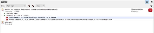

  • Hi Jared
    Thank for sending this code, the only problem is, when I put in
    //IRQ handler
    void I2S_IRQHandler(void)
    if (NRF_I2S->EVENTS_TXPTRUPD == 1)
    NRF_I2S->EVENTS_TXPTRUPD = 0;
    NRF_I2S->TASKS_STOP = 1;
    I get these errors please see attached
    Thank you for all your help
    David
    It's because you have included a source file which already contains the definition of the IRQ handler, the error message specifies that this is first defined in nrfx_I2S. I suggest omitting the driver from the project if you're only going to use the peripheral bare metal.
    regards
    Jared

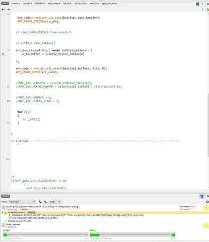

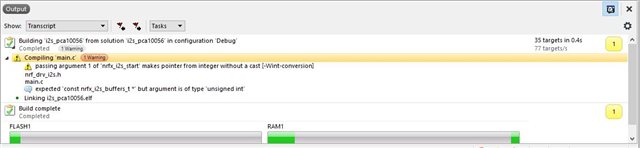

    You're mixing the usage of the driver and writing directly to the peripheral. All calls that starts with NRF_I2S-> is omitting the driver and writing directly to the driver. I suggest that you clean up your code and remove all parts that write directly to the peripheral and only use the driver.
    regards
    Jared

  • Hi
    I have used the driver to config the device but I still have 4 lines of code that are bare bones can you please assist me in converting them to use the driver. Please bare in mind this is the first time I have used your product/code.  my code is below
    #define PIN_MCK (41) //P1.09
    #define PIN_BCLK (40) //P1.08
    #define PIN_LRCK (38) //P1.06
    #define PIN_SDOUT (39) //P1.07
    static void data_handler(nrf_drv_i2s_buffers_t const * p_released,uint32_t status)
    nrf_gpio_cfg_output(LED);
    nrf_gpio_cfg_input(Button, NRF_GPIO_PIN_PULLUP);
    err_code = NRF_LOG_INIT(NULL);
    nrf_drv_i2s_config_t config = NRF_DRV_I2S_DEFAULT_CONFIG;
    config.sck_pin = PIN_BCLK;
    config.lrck_pin = PIN_LRCK;
    config.sdout_pin = PIN_SDOUT;
    config.mode = I2S_CONFIG_MODE_MODE_Master;
    config.sample_width = I2S_CONFIG_SWIDTH_SWIDTH_16BIT;
    config.mck_setup = NRF_I2S_MCK_32MDIV8;
    config.ratio = NRF_I2S_RATIO_512X;
    config.channels = NRF_I2S_CHANNELS_RIGHT;
    err_code = nrf_drv_i2s_init(&config, data_handler);

    Here I have tried to use the nrf_drv_i2s_start  but  giving warnings my array is an int16_t  so have tried to cast, this seems to be what the function expects.
    err_code = nrf_drv_i2s_start((uint32_t)sine_table2, 8192, 0);
    Here are the warnings.
    Can you please advice where I am going wrong.
    Regards
    David
