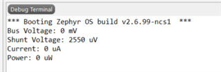

Hello Community,
I'm using the current sensor INA219 with NRF5340dk.
Communication is through i²c protocol and using nrf SDK v1.7.0 .
I'm trying to get the data output (Voltage, Current, Power).
i worked on the sample linked on Zephyr Lib. the problem is that i'm always getting the same output which i liked below
the wiring of the sensor is like below :
Vin->VDD nrf
GND->GND
SCL->P0.26
SDA->P0.25
I'm always getting the current and power to Null values and both voltage values don't change no matter what !
do i need to change the calibration values or do i need to do something else ?
i don't get what's wrong with the data output so i need your help please
can you help me get the right values and get the data displayed out from the sensor correctly, please
Kindly,
Many thanks

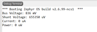

    INA219 examle in Zephyr writes very strange (IMHO incorrect) value into configuration register. Try to replace it with default one:
    	/* Configurate the chip using default values */
    	data[0] = 0x39;
    	data[1] = 0x9f;
  • i already changed that before i putted the message on the forum
    for now i changed the pins and changed my overlay file according to the new pin numbers
    and i always took the comment of Dmitry in consideration and i changed the addresses and now it's being so strange

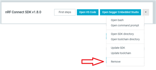

  • It's could be a problem in the build folder, if you haven't deleted it in a while, so you can try deleting it and rebuilding.
    Did you reinstall the v1.8.0 SDK? If you did not, you can try that if deleting the build folder does not work. And like I said in my previous comment, make sure that it is completely finished installing before clicking any buttons.
    By reinstalling I mean removing it and then reinstalling:
  • yeah i did it
    i removed and gave it the time to install correctly
    i deleted the build folder
    i figured out that i didn't add the DK on the plateform_allow in the sample.yaml
    now after i added nrf5340dk_nrf5340cpuapp it works properly and it builds properly
