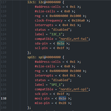

NCS1.8 how to change the SPI1 pins?
NCS1.8.0   Windows10 X64;
spi_loopback test,default code default pins;it is ok.
when i change the SPI_1 pins ,
Failed to achieve the effect, still used the original pins.
thanks
Best Regards
yuyou

    thanks for reply,
    i delete project,reset get project form NCS1.8.0,
    default code #define CONFIG_SPI_LOOPBACK_DRV_NAME "SPI_3"
    only change SPI_3 pins,(mosi-pin to 20)
    It seems that zephyr.dts has not been accepted, even if both files are modified at the same time. reload and recompile, but it still use the old pins.
    thanks
    Best Regards
    yuyou

    i've disabled QSPI and SPI2.
    when i change it to 0x1e,and disabled others,
    the same using old pin.
    when i only change label = "SPI_9" in file zephyr.dts,
    it is still runing spi3.
    so, i think  modifying anything in zephyr. dts doesn't work.
    i do not know how to change it or change it somewhere.
    SDK17 is easy change pin, but NCS1.8 no way.
    thanks
    Best Regards
  • You should not modify zephyr.dts, that will have no effect on the running program. If you read Build System --> Configuration Phase you will see that Zephyr.dts is not used by application and is only meant for debugging, however, the content in the header files devicetree_unfixed.h (located in \zephyr\tests\drivers\spi\spi_loopback\<build folder>\zephyr\include\generated\devicetree_unfixed.h) and devicetree.h (located in \zephyr\include\devicetree.h) is seen and will be used by your application. But you should not modify devicetree_unfixed.h or devicetree.h either. The correct way to do it is to add the content to an overlay file of the name <board name>.overlay (see set devicetree overlays for other options) and put the content in there.
    Do the following to modify the Device Tree (DTS):
    • Create a file named nrf52840dk_nrf52840.overlay (if you use a different board, for example nrf52dk_nrf52832, set it to nrf52dk_nrf52832.overlay) inside \zephyr\tests\drivers\spi\spi_loopback and add the following content:
    &spi1 {
        status = "okay";
        mosi-pin = < 30 >; //0x1e in hex
    &spi2 {
    	status = "disabled";
    &qspi {
    • Delete build folder spi_loopback/<build folder>
    • Build again
      • west build -b nrf52840dk_nrf52840
    • Check the output in spi_loopback/<build folder>/zephyr/zephyr.dts, and you will see that spi2 and qspi is disabled and that spi1 mosi uses the pin 30 (0x1e)
    Simon
