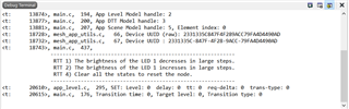

It would run fine with proof in the screenshot below.

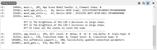

  • I forgot to mention that after step 9), it would show me the following in the main code.
    This is a bit puzzling, as an erase all operation should put the board in a vanilla state. Can you double check everything is in order with the erase by issuing the following nrfjprog commands from a command line?
    • nrfjprog --recover
    • nrfjprog --eraseall
    Also, you see no more activity in the log from the device? It just stays the same, and the phone app goes back to the window listing the device, as if nothing had happened? (Except for the updated connection parameters and MTU, that is.)
    Do you by any chance have an Android device to check if the issue happens also with other implementations than the nRF Mesh iOS app?
