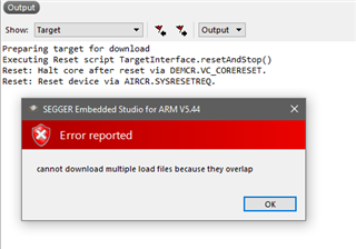

SES project setup with external gcc and S140
  • SES 5.44
  • nRF52840-DK
  • GNU Arm Embedded Toolchain: 9 2020-q2-update from here
  • S140: 7.2.0
  • Project is C code only

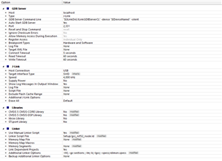

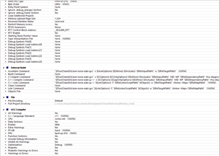

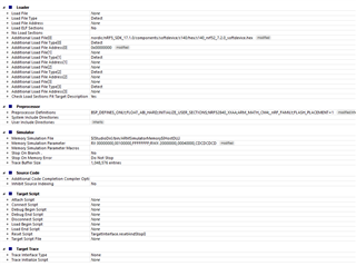

Project Setup:
Linker Script File (copy from examples\ble_peripheral\ble_app_blinky\pca10056\s140\armgcc)

Debug results in
I suspect somewhere it tries to load the S140 or the application again.
