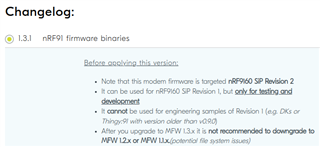

After updating the firmware on NRF9160 Connect DK LED 3 does not turn on and AT commands in LTE Link Monitor yield Error: AT timed out
After updating the firmware on NRF9160 Connect DK (using mfw_nrf9160_1.3.1.zip as well as the ltem asset tracker hex file) LED 3 does not turn on and AT commands in LTE Link Monitor yield Error: AT timed out
I have tried erasing and re-flashing the modem firmware but this yields no change.
