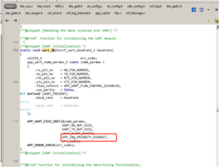

fds_record_find function causes crash
hi,
