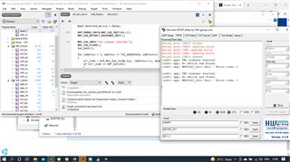

I am trying to interface WM8960 CODEC with nRF52832 using (I2S and I2C) .
Problem I am having is with TWI scanner  and also sending data to the know i2c address . have error code of 1
but as same board . testing with Arduino uno and STM32 boards . the twi scanning gives me result 0x1a (7 bit address)
i am not know why nRF doesn't read the CODEC module address

  • This is the code which i used

        ret_code_t err_code;
        uint8_t address;
        uint8_t sample_data;
        bool detected_device = false;
        NRF_LOG_INFO("TWI scanner started.");
        NRF_LOG_FLUSH();
        twi_init();
        for (address = 1; address <= TWI_ADDRESSES; address++)
            err_code = nrf_drv_twi_rx(&m_twi, (address<<1), &sample_data, sizeof(sample_data));
            if (err_code == NRF_SUCCESS)
                detected_device = true;
                NRF_LOG_INFO("TWI device detected at address 0x%x.", address);
            NRF_LOG_FLUSH();
        if (!detected_device)
            NRF_LOG_INFO("No device was found.");
            NRF_LOG_FLUSH();
    int res = WM89060_Init();
        if(res == 0)  {
          NRF_LOG_INFO("WM89060_Init complete !!\r\n");
        else  {
          NRF_LOG_INFO("WM89060_Init fail ! Error code: %d\r\n", res);
    NRF_LOG_FLUSH();
    i want to setup the scope . i will setup and send you the traces
