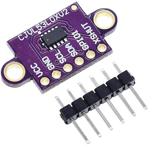

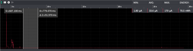

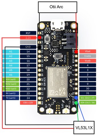

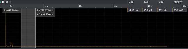

I perform a test on an Icarus board with a VL53L1X sensor, everything works fine. However, in idle/sleep mode, whether I turn off the sensor or not (by XSHUT, GPIO or physically),
it consumes an additional 10uA.
Even without code to initialize the sensor, and only plugging in the SDA & SCL ports, I have a 10uA boost.
I don't understand where this is coming from or how to fix it.
Does someone have an idea ?
Thanks !

    In general the I2C should never be connected without the IC being properly connected on VCC and GND. Some (most?) times the ICs get backpowered from the I2C/UART/etc lines when not properly connected to VCC+GND.

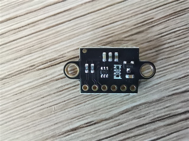

    From what I see there are no pull-ups on the breakout board, so that takes away the possibility of leakage from them.
