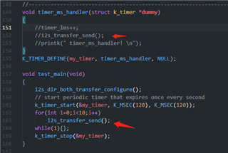

i2s test,see the source code ,
it runing ok;

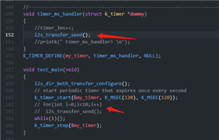

but,when i change to timer send,got error.
i want to send data by timer,

void timer_ms_handler(struct k_timer *dummy)
    //timer_lms++;
	i2s_transfer_send();
    //printk(" timer_ms_handler! \n");
K_TIMER_DEFINE(my_timer, timer_ms_handler, NULL);
void test_main(void)
	i2s_dir_both_transfer_configure();
	// start periodic timer that expires once every second
    k_timer_start(&my_timer, K_MSEC(120), K_MSEC(120));
	// for(int i=0;i<10;i++)
	// 	i2s_transfer_send();
	while(1){};
	k_timer_stop(&my_timer);

ASSERTION FAIL [!arch_is_in_isr() || ((timeout).ticks == (((k_timeout_t) {})).ticks)] @ WEST_TOPDIR/zephyr/kernel/msg_q.c:118

    This API cannot be used from an interrupt context (timer callback in this case). That is why the assert is raised:
    A solution is to use a semaphore like this:
    K_SEM_DEFINE(i2s_transfer, 0, 1);
    	k_sem_give(&i2s_transfer);
    void test_main()
    	while(1) {
    		k_sem_take(&i2s_transfer, K_FOREVER);
    		i2c_transfer_send();
    Vidar
