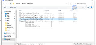

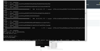

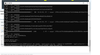

I'm trying meshdfu. Use 52832 to DFU a lantern program according to the official routine. After success, the program can run, but it can't run after DFU with 52840. Here's the process of meshdfu with 52840
If you are trying to do a mesh DFU to the standard blinky application then that application won't work as a mesh node anymore, which won't allow you to do another Mesh DFU. For more info on this issue, take a look at this case here. Using the blinky application for this is mainly done in order to easily showcase that the DFU works.
