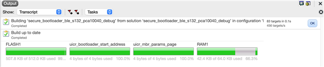

3. Spotting the problem
On the Dev Zone I ran into This Post that suggested that the problem was that my custom board uses the nRF52832-QFAB chip and no the QFAA version. The QFAA chip has 512kb of FLASH and 64kb of RAM, but the QFAB chip has 256kb of FLASH and 32kb of RAM. This suggests that the chip is running out of memory and the memory mapping configurations are wrong so the bootloader can't find the app on the initialization process.
If I look at the bootloader project build result it shows:
So the bootloader is using more FLASH (507.8kb) and more RAM (42.4KB) than is available on the  QFAB chip.

4. Trying Solutions (without success).
As This Post suggests, I changed the project configuration.
1. Changed  Common/Code/Linker/Memory Segments to :
FLASH1 RX 0x0 0x40000;RAM1 RWX 0x20000000 0x8000;mbr_params_page RX 0x0003E000 0x1000;bootloader_settings_page RX 0x0003F000 0x1000;uicr_bootloader_start_address RX 0x10001014 0x4;uicr_mbr_params_page RX 0x10001018 0x4
2. Changed Common/Code/Linker/Section Placement Macros to :
FLASH_PH_START=0x0
FLASH_PH_SIZE=0x40000
RAM_PH_START=0x20000000
RAM_PH_SIZE=0x8000
FLASH_START=0x38000
FLASH_SIZE=0x6000
RAM_START=0x20005968
RAM_SIZE=0x2698
3. Changed Common/Code/Preprocessor/ Preprocessor Definitions NRF52832_XXAA to NRF52832_XXAB:

Now I ran into this problem: I try to build the project but I cant. I get this error:
Building ‘secure_bootloader_ble_s132_pca10040_debug’ from solution ‘secure_bootloader_ble_s132_pca10040_debug’ in configuration ‘Release’
  Compiling ‘main.c’
  Linking secure_bootloader_ble_s132_pca10040_debug.elf
    .text is too large to fit in FLASH1 memory segment
    .dfu_trans is too large to fit in FLASH1 memory segment
    .svc_data is too large to fit in FLASH1 memory segment
    .log_const_data is too large to fit in FLASH1 memory segment
    .nrf_balloc is too large to fit in FLASH1 memory segment
    .log_backends is too large to fit in FLASH1 memory segment
    .sdh_ble_observers is too large to fit in FLASH1 memory segment
    .sdh_req_observers is too large to fit in FLASH1 memory segment
    .sdh_state_observers is too large to fit in FLASH1 memory segment
    .sdh_stack_observers is too large to fit in FLASH1 memory segment
    .sdh_soc_observers is too large to fit in FLASH1 memory segment
    .fs_data is too large to fit in FLASH1 memory segment
    .rodata is too large to fit in FLASH1 memory segment
    .data is too large to fit in FLASH1 memory segment
    .bss is too large to fit in RAM1 memory segment
    section .heap overlaps absolute placed section .stack
    .mbr_params_page is too large to fit in FLASH1 memory segment
    .bootloader_settings_page is too large to fit in FLASH1 memory segment
    section .stack VMA [0000000020007800,0000000020007fff] overlaps section .bss VMA [00000000200059d0,000000002000a1d7]
Build failed
So it seems that I am still running out of FLASH and that the project is using 507.8kb of Flash which is more than the 256kb of FLASH available on the QFAB version of the chip.
I also tried memory mappings from This post 1, This Post 2 and, This Post 3 without success, all the mappings are similar but slightly different. And the error is always FLASH shortage.
So, In synthesis, I cannot build the project with what I think are the correct memory mapping configurations for the nRF52832-QFAB chip

  • Hi Agustin,
    Could you send us the project you created, both the bootloader and the ble_app_blinky ?
    What you did in 4.3 seems to be correct. However at 4.1 I think the correct address should be :
    FLASH_PH_START=0x0
    RAM_PH_SIZE=0x8000
    FLASH_START=0x31000
    FLASH_SIZE=0xd000
    RAM_SIZE=0x2698
    The reason for that is that you were building the secure_bootloader\pca10040_s132_ble_debug variant. If you build the secure_bootloader\pca10040_s132_ble you can use what you used. This explain why you get the "too large to fit in flash" error.
    In the ble_app_blinky , you should also change the FLASH SIZE and RAM SIZE accordingly.
    I would suggest to stick to the bootloader _debug variant  so that you can debug it. You can add a breakpoint inside dfu_enter_check() and check why it doesn't enter the app.
    There could be a chance that NRF_BL_DFU_ENTER_METHOD_BUTTON was enabled and the NRF_BL_DFU_ENTER_METHOD_BUTTON_PIN (by default P0.16) was in active level causing the bootloader to stay in DFU mode.

    I changed the Section Placement Macros in the _debug project version as you suggested. I still can't build the project, but the errors were reduced to:
    Build failed
    This suggests that there is still a FLASH shortage problem and a RAM Shortage Problem.
    For the non-debug project (and my original Section Placement MAcros suggestion) the build errors are:
      Linking secure_bootloader_ble_s132_pca10040.elf
        section .stack VMA [0000000020007800,0000000020007fff] overlaps section .bss VMA [00000000200059b4,0000000020007f63]
    Build failed
    In this case there is only a FLASH shortage.
    I have NRF_BL_DFU_ENTER_METHOD_BUTTON defined as "0" so there is no pin activating the DFU mode on the custom board. Also, as a redundancy, I have defined NRF_BL_DFU_ENTER_METHOD_BUTTON_PIN as "4" since P0.4 is a button on my custom board that I can easily control.
    I have adjusted FLASH size and RAM size accordingly on the ble_app_blinky project. The project builds without any errors and I can run it without problems on my custom board by uploading it using SES (I can not use DFU since the bootloader does not build).
    Finally, here I attach the ble_app_blinky project, the pca10040_s132_ble project, and the pca10040_s132_ble_debug project that I am using.
