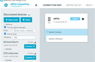

I am testing direct advertising with two nRF52-DK. One performs a direct advertising and the other scans for the directed adverts. Unfortunately, the scanning device cannot see the directed advertising packages.
For simplicty and to reduce variables, I have set a test where I use the below code on a nRF52 dk (nRF52832) and the BLE tool on the nRF Connect SDK for Desktop (using a nRF52840-donge). I have hardcoded the dongle address on the directed advertiser code. Unfortunately, I still cannot see the directed advertising packages. Why is that? Any help most welcome.

BLE Tool
  • Hi Armand
    I don't think the Bluetooth application in nRF Connect for Desktop will show anything if a directed advertising packet is received. These packet doesn't really contain any data to show, just the peer address.
    The same goes for extended advertise packets, I will need to check with the developers if this is supported.
    I will get this confirmed during office hours tomorrow.
    Have you tried to set up the other board to run a scanner example instead?
    This should work, as long as you use comparable settings.
