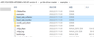

    I implemented part of the code following the example given.
    At present, you can open the COM port and start scanning ble devices.
    The problem I currently encounter is that the device can only scan one device. The situation is as follows:
    Where I set a breakpoint, I always receive advertising messages from the same device。But there are a lot of Bluetooth devices around me。
    The code also sets the maximum number of devices to 8, as shown in the figure below:
    In addition, the example I refer to is shown in the figure below:

    6. Do you have multiple devices running with the heart_rate_monitor example project? It only scans for devicies advertising the heart rate service by default, so you need to edit the scan parameters to allow all devices to be visible.
