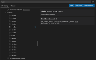

Hello All,
I am new to zephyr. How to set BLE Advertising Tx power? like for example, I want to set 0dBm.
Thanks in advance
Neeraj Dhekale
  • Hi Neeraj
    If you just need static TX power control you can use one of the BT_CTRL_TX_PWR configurations, which can be changed through the Kconfig configurator in VSCode like this:
    Or you can just add one of the configurations to your prj.conf file, like this (for 4 dBm TX power):
    CONFIG_BT_CTLR_TX_PWR_PLUS_4=y
