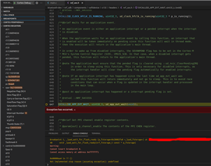

    I am using copied parts of code from fstorage example. When the code calls wait_for_flash_ready() it reaches SVCALL(SD_APP_EVT_WAIT, uint32_t, sd_app_evt_wait(void)); in nrf_soc.h (sdk/components/softdevice/s132/headers) and there an exception occurs.
    What kind of error is thrown? Could you share a screenshot from debug view highlighting the error?

  • There is no error during J-Link - terminal debugging but using Cortex Debug plugin in VSCode throws "Exception has occured" as a baloon and not much else. In terminal I can see that even if I let the program run without breakpoints it stops at specific points where flash is erased or written to.

    I found out why previously I just used __WFE(). Function power_manage from fstorage example has a macro that depends on SD (if it is present) but the only difference is that with SD present it returns NRF_SUCCESS. If I put __WFE() into my wait_for_flash_ready function it will crash. __WFE is a macro defined in CMSIS, so it should be properly working. I will investigate how the CMSIS is used as that will probably be the source of all this hassle.
    [I was wrong here. VSCode sent me to wrong file (nrf_soc_nosd). I should've looked at softdevice/s132/headers/nrf_soc.h and here sd_app_evt_wait is called by SVCALL which causes the fault. Anyway, __WFE used directly causes fault too, but it should not be used with SD.]

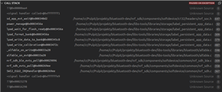

    Could you show the call stack from debug view? What context are you calling wait_for_flash_ready() from, and what interrupt priority do you have on the fstorage module?

  • In the attachement there is a screenshot of call stack from VSCode.
    I'm calling wait_for_flash_ready() right after nrf_fstorage_write or nrf_fstorage_erase. I was looking through the code but I cannot find any interrupt priority modifications. In the code I have a comment by my predecessor:

    The call stack shows that the wait_for_flash_ready() is called in interrupt context from a BLE event, which again calls the sd_app_evt_wait(). This is most likely causing the issue because the program is waiting for a lower priority event to complete from a higher priority event.
    If you want to do a reset after the wait_for_flash_ready() has completed then I would first move wait_for_flash_ready() to the main loop so that it runs in the main context. Next, set a flag in the BLE interrupt routine that is checked in the main loop and signalizes that wait_for_flash_ready() can be called. After that I would use the power management module and call NRF_PWR_MGMT_CONFIG_AUTO_SHUTDOWN_RETRY instead of sd_app_wait() for the nRF to reset. See the power management example in the SDK for a reference on how the module is used.
