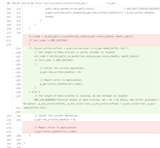

    I added some logging to the QWR library and reproduced the issue.
    Error case (data written > QWR buffer length):
    <info> app: User mem reply 625 bytes
    <info> app: Prepare write offset 0 length 288
    <info> app: Prepare write offset 288 length 288
    <info> app: Prepare write offset 576 length 288
    <info> app: Error 8 occurred when sending response
    <info> app: User mem release
    Success case (data written < QWR buffer length):
    <info> app: Prepare write offset 288 length 184
    <info> app: Execute write offset 0 length 0

  • I attached an example project modified from the stock qwr example to extend the mtu and maximum characteristic length. Place in examples/ble_peripheral/experimental. Write >512 bytes of data to the characteristic from an iPhone and the problem is exhibited.ble_app_queued_writes.zip
    Strangely, with the default MTU and characteristic fixed length and length (128) configuration, I saw the same issue occurring but in on_execute_write when it attempts to respond. My guess is that because the characteristic data length is not variable, when the SD gets more data than the characteristic length it responds instead with incorrect length error and triggers a BLE_GATTS_OP_EXEC_WRITE_REQ_NOW event instead. But the SD should also surely respond with the invalid length error when the characteristic is variable and the prepare writes go beyond the maximum length of the characteristic? This would seem like a SD bug.
    FWIW, my fix for QWR library looks like this:
    if ((p_evt_write->offset + p_evt_write->len) <= p_qwr->mem_buffer.len) {
            // the length of data written is valid, attempt to respond
            err_code = sd_ble_gatts_rw_authorize_reply(p_qwr->conn_handle, &auth_reply);
            if (err_code != NRF_SUCCESS)
                // Cancel the current operation.
                p_qwr->nb_written_handles = 0;
                // Report error to application.
                p_qwr->error_handler(err_code);
        } else {
            // The length of data written is invalid, do not attempt to respond
            NRF_LOG_WARNING("Invalid length of data written: %d + %d = %d bytes, mem buffer provided = %d bytes", p_evt_write->offset, p_evt_write->len, p_evt_write->offset + p_evt_write->len, p_qwr->mem_buffer.len);
    Fixing the similar issue in on_execute_write might be more difficult as I'm not sure the library can know the fixed length of the characteristic...
