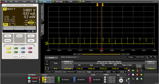

I used nordic ble_app_pwr_profiling,nordic PCA10040,test instrument is N6705C,but my test is 6-7uA,why?

Can you just do a simple:
while(1)
__WFE();
Also make sure you read:
https://infocenter.nordicsemi.com/topic/ug_nrf52832_dk/UG/nrf52_DK/hw_meas_current.html
Kenneth

I used rtc app,modify flow code:
while (true)
//__SEV();
//__WFE();
__WFE();
the reset is:4-5 uA
And there's another problem,I'm not sure what makes the little spear??
thanks,Best regards.
hi kenneth:
Power the DK from a coin cell battery,That problem has been solved!
These spikes are likely the internal regulator in the nRF52-series operating in refresh mode, refresh mode will turn ON the regulator for short periods instead of continoustly be turned ON. This is to save power, you can find more information about "refresh mode" if you search here in devzone.
Kenneth
