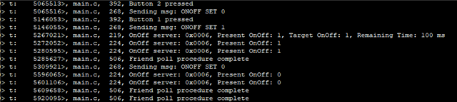

    Unfortunately I do not receive such a status update at the LP node. The only messages I see, when the LPN established a friendship are the following:
    <t: 2112622>, main.c, 481, Friend poll procedure complete
    <t: 2423083>, main.c, 481, Friend poll procedure complete
    <t: 2733507>, main.c, 481, Friend poll procedure complete
    <t: 3043956>, main.c, 481, Friend poll procedure complete
    <t: 3354407>, main.c, 481, Friend poll procedure complete
    Shouldn't I see a LED status update at the LPN node if the LED status at the server node changed?

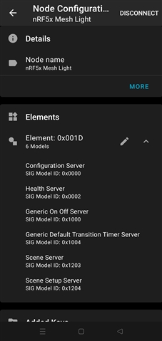

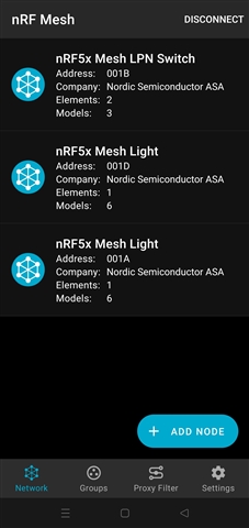

    Here you see the three Nodes in my App:

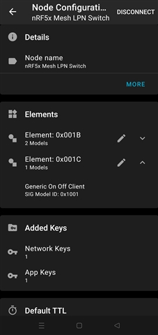

    The LP Node with its Elements and its Elements Adresses:

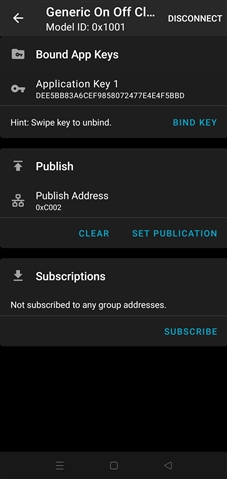

    The Setting I am using for the Generic ON OFF Client of the LP node:
    It publishes to the Group 0xC002 and is not subscribed to anything.

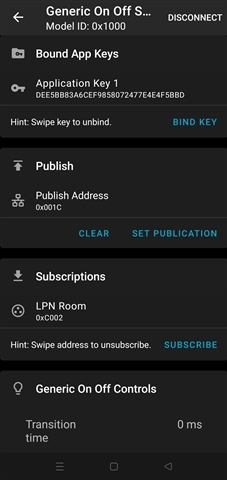

    Then the elements of the light server with the corresponding adresses:
    The Setting of the Generic On Off Server of the Light Server Node:
    (The Light Server publishes directly to the LPN Node Element with adress 0x001C and is subscribed to the Group 0XC002).
