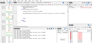

ble_app_beacon example stucking after once advertise.
I successfully merge example libuarte and ble_app_beacon and built .
My problem started after it receive 48 bytes of data  from sensor via uart ,This is my area of doubt .
In nrf connect android app I am able to see data but it is not changing .
For verification I try to debug and in debug terminal also I found it is advertising once.
for reference ,I am adding debug terminal snapshot below.
In debug terminal one can clearly see that it is running but not going to update function.
I am attaching my uart read and advertise update function below.

    I have strongly doubt on UART_Handler  please review 1st this part because my sensor giving 48 bytes of data in every seconds.

    I found 2 problems with your code.
    1. strcat will just keep appending characters to your rx_buffer until it eventually overflows if you are not null terminating your string. You could try something like this to prevent it from happening:
    void uart_event_handler(void * context, nrf_libuarte_async_evt_t * p_evt)
        nrf_libuarte_async_t * p_libuarte = (nrf_libuarte_async_t *)context;
        uint16_t string_len = strlen(rx_buffer);
        uint16_t buf_len = sizeof(rx_buffer);
        uint16_t bytes_left = (buf_len - string_len);
        ret_code_t ret;
        switch (p_evt->type)
            case NRF_LIBUARTE_ASYNC_EVT_ERROR:
                bsp_board_led_invert(0);
            case NRF_LIBUARTE_ASYNC_EVT_RX_DATA:
                if (string_len < buf_len)
                    strncat(rx_buffer, p_evt->data.rxtx.p_data, bytes_left);
                    NRF_LOG_INFO("Bytes received: 0x%x", p_evt->data.rxtx.length)
                    NRF_LOG_INFO("Bytes appended to buffer 0x%x", ((bytes_left) <= p_evt->data.rxtx.length)
                                                                 ? bytes_left
                                                                 : p_evt->data.rxtx.length);
                else
                    NRF_LOG_INFO("rx_buffer is full");
                nrf_libuarte_async_rx_free(
                    p_libuarte, p_evt->data.rxtx.p_data, p_evt->data.rxtx.length);
            default:
    2. manuf_specific_data in advertising_init must be placed in static memory:
        uint32_t err_code;
        uint8_t flags = BLE_GAP_ADV_FLAG_BR_EDR_NOT_SUPPORTED;
        static ble_advdata_manuf_data_t manuf_specific_data;
