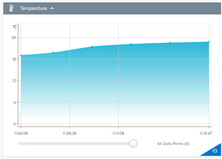

We'd like to use Thingy91 to measure temperature, but it looks like the thermometer (BME680 onboard) gets heat up, when Thingy91 is running for some time.
I placed the device next to analog thermometer showing 19°C. The device wasn't powered on for a day, so should have the same temperature. When I powered on Thingy91 (on battery) with Asset Tracker v2 app, it started to send data to cloud and at start it was indeed 19°C, but after two minutes it got to 23.5°C (see image below). I took out the board from the plastic box, so it's not the proximity of the battery - it probably is heated by circuits around
How could we work around this issue? Is it possible to somehow calibrate the sensor or should we apply the correction ourselves?

    The increase of the temperature is basically coming from two points, GPS and Charging:
    1. Default settings in Asset Tracker v2 will turn ON the GPS in specific intervals and that will increase the temperature on the PCB close to the sensor. To disable the GNSS just disable the module in the configuration file "prj.conf" [CONFIG_GNSS_MODULE=n]
    2. Charging the device can also increase the temperature. To fix that you would only power the Thingy:91 with the battery (USB disconnected) or disconnect the battery and power the Thingy:91 with the USB only"

  • Thank you, I've added CONFIG_GPS_MODULE (not GNSS, this didn't work) and also added low-power overlay (disables LED, logging etc.) and we got 21.9°C, which is definitely better
    I've tested everything on battery-only, probably we'll remove batteries on production then. I'm looking forward to new features
