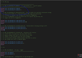

  • I have solved that issue. Can you help me with one thing. I am receiving lot of data from the other MCU via libuarte. I want to print that data on the RTT terminal... How can I do that using NRF_LOG_INFO??
    My libuarte handler is as follows:-
    void libuart_event_handler(void *context, nrf_libuarte_async_evt_t *p_evt) {
    static uint8_t index;
    nrf_libuarte_async_t *p_libuarte = (nrf_libuarte_async_t *)context;
    ret_code_t ret;
    switch (p_evt->type) {
    case NRF_LIBUARTE_ASYNC_EVT_ERROR: {
    NRF_LOG_ERROR("LIBUARTE ERROR");
    case NRF_LIBUARTE_ASYNC_EVT_RX_DATA: {
    // Receive complete
    memset(buffer,'0',sizeof(buffer));
    memcpy(buffer, p_evt->data.rxtx.p_data, p_evt->data.rxtx.length);
    int data_length = p_evt->data.rxtx.length;
    nrf_libuarte_async_rx_free(p_libuarte, p_evt->data.rxtx.p_data, p_evt->data.rxtx.length);
    case NRF_LIBUARTE_ASYNC_EVT_TX_DONE: {
    // Transmit complete
    How can I print the buffer values on RTT?? Size of buffer is 256.
    Snehal
  • Hi ,
    You need to set the logger backend in the sdk_config.h file from UART to RTT.
    regards
