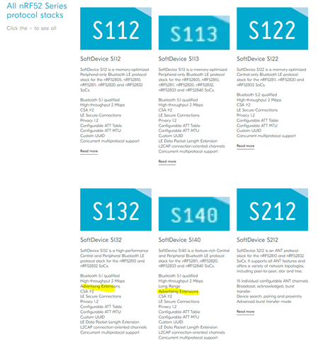

    I'm sorry that I didn't notice that you were using nRF52811. If you use nRF52811 and S112, advertising extension is not supported. I would suggest to switch to nRF52832 and you can use S132 which supports it.

    I saw your shared image. In S140, it supports the Advertising extension also for chips nRF52811 and nRF52820.
    Is anything changes have to do in S140 to load to nrf52820?
  • Hi Bosemani,
    Yes you can use S140 on a nRF52811 but the problem of that is that the S140 requires 156kB of flash when the flash size of nRF52811 is 192kB.
    So the softdevice occupied most of the flash space of the nRF52811 and there is very little space left for the bootloader and the application. If you don't plan to do DFU update for your product then it would be fine but if you want to update the application via OTA DFU then it could be a challenge.
