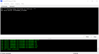

  • I tried using SES and I was not able to see the RTT log either. However, I tested with J-Link RTT Viewer V7.5.8 and that worked fine:
    Could you test that?

  • Thank you Simon.
    Now when I use the nRF52833DK board I can see the debug logs with both J-Link RTT Viewer V7.58B and SES Debug Terminal. However, when I flash it on our target board (based on nRF52833 SoC) I can see the debug logs in RTT Viewer but not in the SES Debug Terminal. Also, when I flash the same .hex file to our board that uses the secure B version of the nRF52833 SoC I don't see any logs in either RTT Viewer nor SES Debug Terminal.
