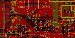

Scoping location:
In the end I used my oscilloscope and scoped the output from the SAM IC to the input to the nrf52840 on P0.06 and TP4. Leaving my probe on TP4 and doing a fresh power up I note the following:
- No default output occurs from SAM -> 52840
- Open Com port with baud @ 115200, no hw control IOs set
- Send 1 byte through 0x30
- This comes up correctly as 0x30 on the scope
- send through 0x31, this reads as 0x30 on scope
- send through 0x32, this comes up as 0x31
- send through 0x32, this comes up as 0x32
- send through 0x33, this comes up as 0x32
- and repeat

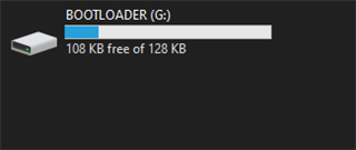

It appears as though there might be a bug on my nrf52840dk jlink OB IC. I am unsure how/when this occurred as I believe it used to work just fine and this is a recent acquisition. on my DK, the SAM IC has the following information printed on it:
- PCA10056
- 2.0.1
- 2020.13
- 683824488
I do not believe that I updated my SAM IC's firmware at any point, though if I did, what would be the procedure for reflashing this IC? I do have an external JLink programmer and the special 2x5 1.27mm spring pin cable for programming it if required.
