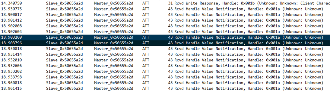

  • Here is my sniffer.
    ConnectionInterval30ms.pcapng
    My connection interval is set at 30ms,and the 6th byte of my data packet will display the current data packet volume (range 00~FF).
    You can see that the packet at the marker is wrong and multiple packets cannot be generated within 1 interval
  • Thank you for providing the sniffer trace.
    As you see from the image below, more data is 'False'. This means there is no more data to transmit.
    The marked package contained '0a', which means some values are missing and were not transmitted. What probably happened is that a buffer in the SoftDevice was full.
    The question now is how you are queuing your data? You will need to have a good way to queue your data that suits your application.
    The GATTS Handle Value Notification documentation includes two different variants demonstrating how to queue your data.
    One option is to implement your own way to keep track of how many elements you have queued(Variant #2). Another option is to monitor whether NRF_SUCCESS or NRF_ERROR_RESOURCES is returned each time you queue an element(as in Variant #1).
