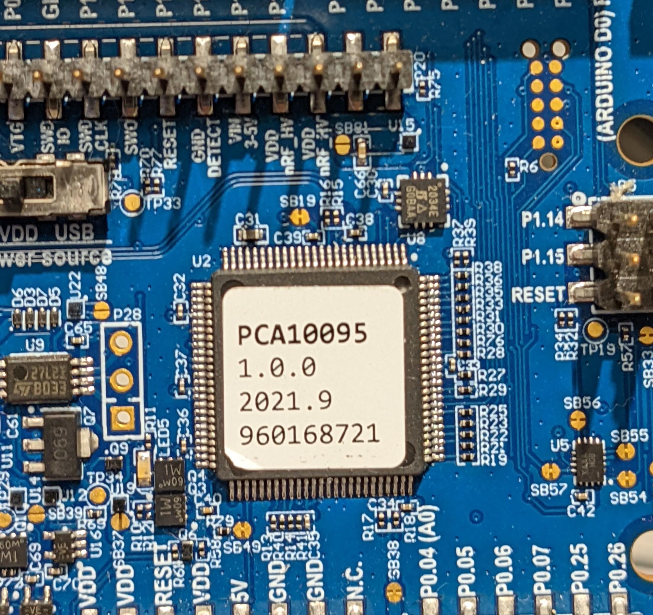

    The Device ID / Kit ID is unique for the DK and can be found on the White Label on the Debugger:
    It goes in the order of:
    PCA number
    DK version
    Production Date/Week
    Kit ID / Device ID

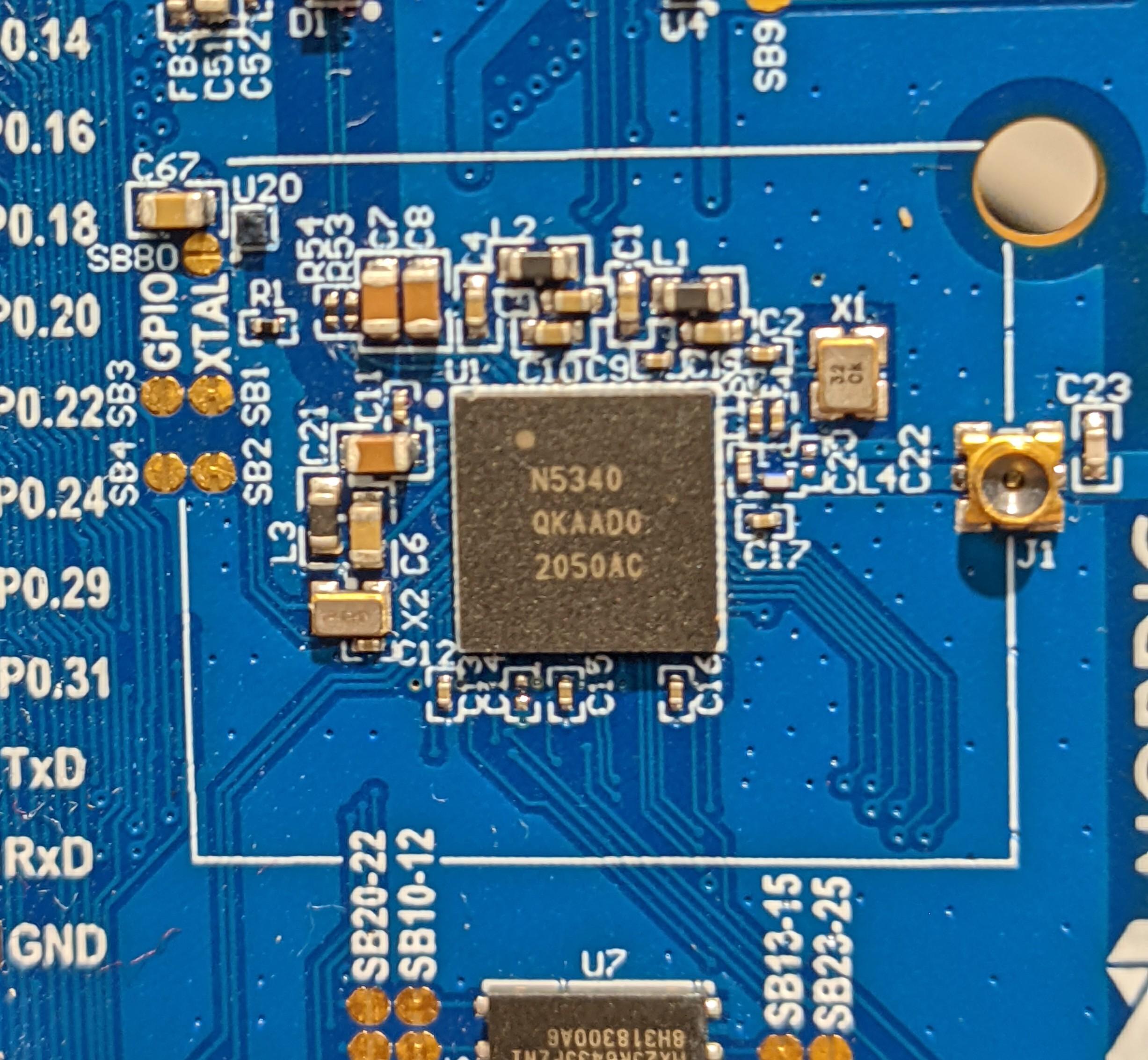

    Then the chip ID can be found on the chip itself:
    You could take a look here.

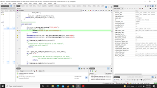

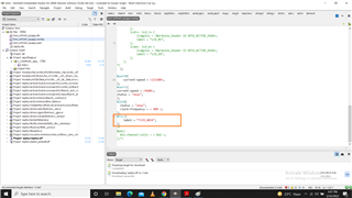

  • Dear Priyanka, where is the suggested API located in nrc folder to include in my code ? May, you show any example where used this API ? I included #include <hal/nrf_ficr.h> in the main file. The CMake Compil and Build is sucessful. When, Debug using nRF5340DK, then filed to get binding ... see atached images. What should be written in prj file ? or what else to do ?
