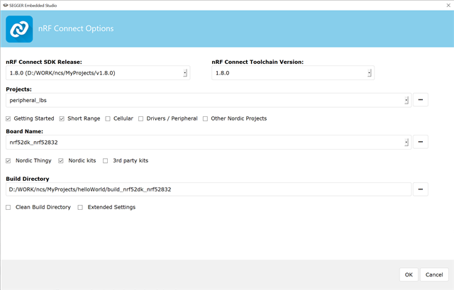

Just started to learning following the tutorial  here - https://devzone.nordicsemi.com/nordic/b/archives/posts/nrf-connect-sdk-tutorial---part-1-ncs-v1-3-0#h769sk6kqovea15p99jn16lstat1dtpuuw
Try to create a solution from scratch by following above tutorial - it is a good tutorial, but it is not up to date with latest SDK version v1.8.0, I am struggling to follow. it doesn't allow me to create a my own project called helloWorld like below in projects.
I am new to Nordic SES and urgently need to develop something for our new gateway product which uses Fanstel833 chip.

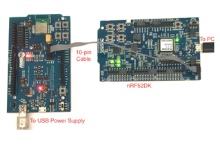

    I see, yes, I use nRF52DK_nRF52832 board. I suppose I can use it to program/debug the Fanstel 833A board, is this right?
    Regards!
    Ping
  • Hi Ping,
    Yes, correct. You can use the nRF52 DK to program and debug the Fanstel board. Given that you power the Fanstel board with 3.3V.
    The nRF52DK can't program the external board if the external board powered by 1.8V only 3.3V supported.
  • Hi, Hung
    Just try to check the PSU - it looks like can be powered by USB, I am not sure the supply voltage in this case. And also there are 2 USB ports there - J17 and J16, not sure which one to use. Also noticed there is external supply - 3V. Not sure how I am supposed to power it up in order to program and debug it. I am using EV BM833A board.
    could you advise pleas?
    Regards!
    Ping
    Please read the datasheet of the EV BM833A board.
    Here is the picture from page 24:
