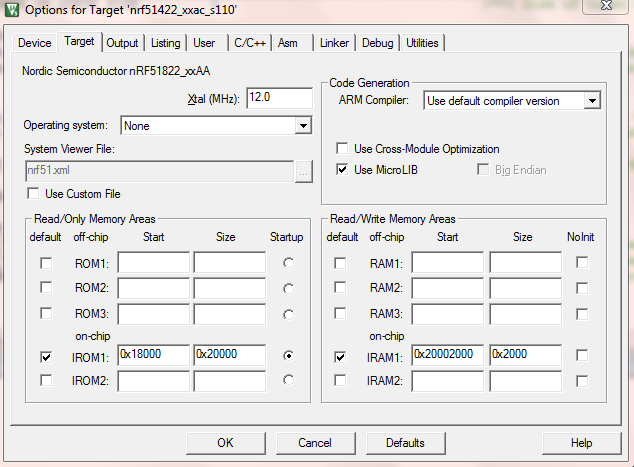

Hello, I am trying to load ble_app_beacon code provided in nordic sdk to redbear lab's ble nano. I am using sdk version 8.0.0 and soft device(s110) version 6.2.1 .
I am able to compile the code in keil uVision 5 and load it in ble nano hardware but it's not transmitting anything. I am not able to detect any ble device. I am using below target setting in keil,
image descriptiont
Can anyone please help me with the issue?
  • SoftDevice 6.2.1 is not compatible with SDK 8.0.0, please use SoftDevice 8.0.0 with SDK 8.0.0, 8.1.0, or 9.0.0. Or use SoftDevice 6.2.1 with SDK 5.2.0. Please see Table 4 in the nRF51 Series Compatibility Matrix for more information, you can find it here.
    If you don't want to change versions you should try the debugger to see what is happening.
