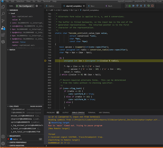

I have a clean sample problem
1) Installed a clean install or nRF connect v1.9.0 at c:\nRF
2) Installed the VSCode as recommended
3) Pressed Create a new application from sample
4) Added a new board configuration NRF5340 DK NRF5340 CPU App ns
5) Plugged in a brand new nRF5340 dev kit from an unopened box
6) Build all

8) Press start debugging:
DEBUG CONSOLE
Launching GDB: "c:\\nRF\\v1.9.0\\toolchain\\opt\\bin\\arm-none-eabi-gdb.exe" -q --interpreter=mi2 "c:\\Projects\\Lismore\\BTFirmwares\\CP100GW\\build\\zephyr\\merged_domains.hex"
Set "showDevDebugOutput": true in your "launch.json" to see verbose GDB transactions here. Helpful to debug issues or report problems
Reading symbols from c:\Projects\Lismore\BTFirmwares\CP100GW\build\zephyr\merged_domains.hex...
(No debugging symbols found in c:\Projects\Lismore\BTFirmwares\CP100GW\build\zephyr\merged_domains.hex)
WARNING: Cortex-Debug will deprecate use of GDB version 8. Please upgrade to version 9+
Launching gdb-server: "C:\\Program Files (x86)\\SEGGER\\JLink\\JLinkGDBServerCL.exe" -singlerun -nogui -if swd -port 50000 -swoport 50001 -telnetport 50002 -device nRF5340_xxAA_APP -select usb=960141058 -rtos "C:\\Program Files (x86)\\SEGGER\\JLink\\GDBServer\\RTOSPlugin_Zephyr.dll"
Please check TERMINAL tab (gdb-server) for output from C:\Program Files (x86)\SEGGER\JLink\JLinkGDBServerCL.exe
0x00000928 in ?? ()
Program stopped, probably due to a reset and/or halt issued by debugger
add symbol table from file "c:/Projects/Lismore/BTFirmwares/CP100GW/build/zephyr/zephyr.elf"
(y or n) [answered Y; input not from terminal]
Reading symbols from c:/Projects/Lismore/BTFirmwares/CP100GW/build/zephyr/zephyr.elf...
add symbol table from file "c:/Projects/Lismore/BTFirmwares/CP100GW/build/spm/zephyr/zephyr.elf"
Reading symbols from c:/Projects/Lismore/BTFirmwares/CP100GW/build/spm/zephyr/zephyr.elf...
Resetting target
Resetting target
Run to 'main' timed out. Trying to pause program
Program
 received signal SIGTRAP, Trace/breakpoint trap.
cbvprintf (out=0x565 <char_out>, ctx=0x20002edc <z_interrupt_stacks+1972>, fp=0x9411 "%c: Faulting instruction address (r15/pc): 0x%08x\n", ap=...) at C:/nRF/v1.9.0/zephyr/lib/os/cbprintf_complete.c:1371
1371        while (*fp != 0) {
I must have missed something simple?

    Which sample are you using? From the screenshot it looks like you are using peripheral_lbs and are building for nrf5340dk_nrf5340_cpuapp_ns. However the sizes you get do not match what I get after building, which is:
    [258/263] Linking C executable zephyr\zephyr.elf
               FLASH:      132092 B       952 KB     13.55%
                SRAM:       24228 B       416 KB      5.69%
            IDT_LIST:          0 GB         2 KB      0.00%
    Also, when I test this combination with nRF5340 DK and NCS 1.9.0 from the toolchain manager it build out of the box, and debugging also works out of the box.
    Which OS are you using on your computer? Can you show your build configuration? I tested with this:
    While that should not be relevant here, note that when you build for non-secure (last part of target is "_ns") you automatically get TF-M included, and that is still experimental in nRF Connect SDK 1.9.
  • Hi Einar,
    Yes i have selected the peripheral_lbs sample

    Try to debug:
    Launching GDB: "c:\\nRF\\v1.9.0\\toolchain\\opt\\bin\\arm-none-eabi-gdb.exe" -q --interpreter=mi2 "c:\\Projects\\Lismore\\BTFirmwares\\IC1GW\\peripheral_lbs\\build\\zephyr\\merged_domains.hex"
    Reading symbols from c:\Projects\Lismore\BTFirmwares\IC1GW\peripheral_lbs\build\zephyr\merged_domains.hex...
    (No debugging symbols found in c:\Projects\Lismore\BTFirmwares\IC1GW\peripheral_lbs\build\zephyr\merged_domains.hex)
    0x00001c3c in ?? ()
    add symbol table from file "c:/Projects/Lismore/BTFirmwares/IC1GW/peripheral_lbs/build/zephyr/zephyr.elf"
    Reading symbols from c:/Projects/Lismore/BTFirmwares/IC1GW/peripheral_lbs/build/zephyr/zephyr.elf...
    Resetting target
    Resetting target
    [New Remote target]
    Thread
    2 received signal SIGTRAP, Trace/breakpoint trap.
    [Switching to Remote target]
    0x000001a4 in ?? ()
    It seems to have got further, but will not hit my breakpoint, if i hit continue,
    i never get out of this cbprintf_complete file
    It looks like the problem is the version of the board i am using.
    PCA10095 0.8.0 2019.51 - causes me the problems
    PCA10095 2.0.0 2011.42 - Is advertising - and i can debug!
