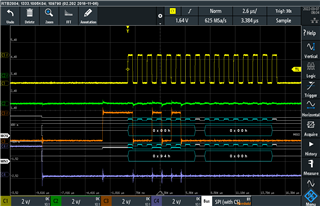

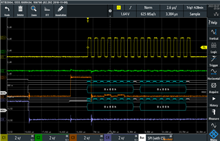

  • I implemented the driver and now I try to communicate over the SPI with the nRF21540.
    First, I try to read the Partnumber. When I set the power doen off, the SPI signals are ok, but of course I have no feedback from the MISO.
    Signals ok:
    As soon as I set PowerDown = ON = nRF21540 enabled, the second SPI MOSI pulse is there, but really low (nRF21540 pulls down the level!)
    What is the reason of this and how this can be solved?
