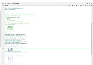

I am working on establishing an UART connection with Zephyr between NRF5280 and NRF9160 microcontroller (Thingy91 Prototyping board).
The standard uart_poll_out() function works seamlessly with 8 bit char datatype sending messages between both microcontrollers.
The uart_poll_out_u16() function with 16 bit unsigend integer datatype leads to a Bus Fault error (z_arm_exc_spurious).
CONFIG_UART_WIDE_DATA is set to yes, and CONFIG_UART_INTERRUPT_DRIVEN is enabled.
Is 16 bit UART communication with Zephyr currently supported for the Nordic boards or does only 8 bit UART work?
Attached a snippet of the used code and the full code as ZIP file.
